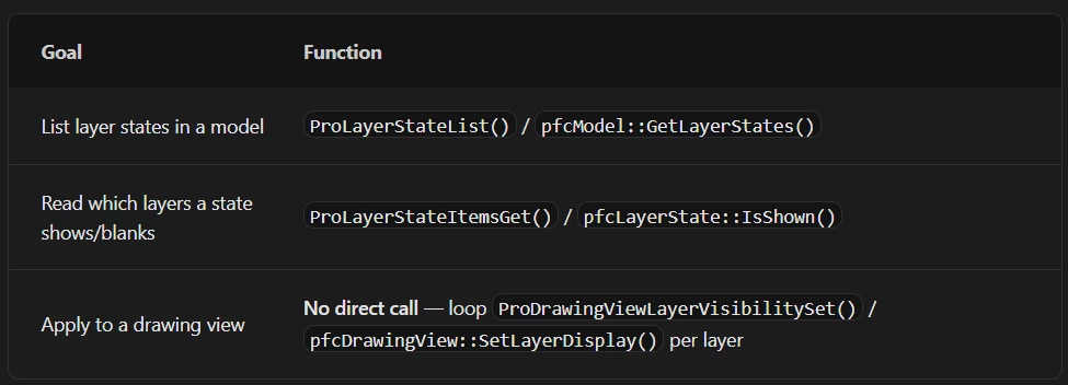

    I have many ideas for such utilities. One example is for a utility that will set the layer display in selected drawing views (or all views on a dwg sheet) independent of the model layer display in an automated fashion. Drawing templates do not support the definition of layer states in a template. Upon cursory inspection it appears that the calls are available to implement this depending on which API you are working with. If the function call exists to assign a layer state to a view on a drawing sheet independent of the model layer display, then it should be workable.
    If you are interested in developing this then we can have a discussion directly to generate a product requirements document for the functionality in detail. I assume you would not want to load such details into this thread for every idea explored.

    Here is a link to an older post where I was seeking a solution to automating this process.
    https://community.ptc.com/3d-part-assembly-design-327/drawing-template-layers-possible-to-define-layers-for-template-views-162412?tid=162412&fid=327
    Michael_Bourque
    Oct 19, 2026 10:26 PM UTC
    Send me a PM and we can discuss but I think this is certainly doable.
