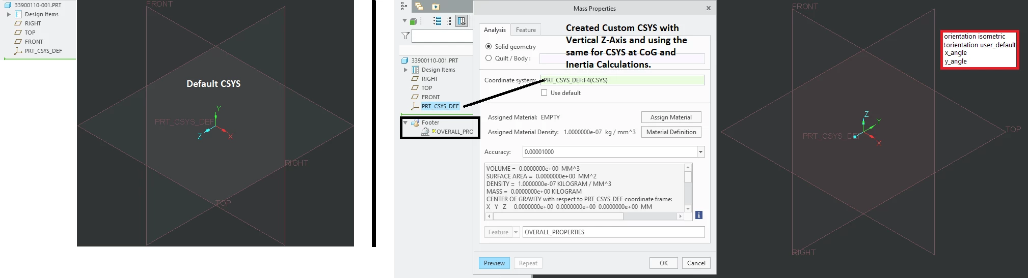

I want to setup Z-Axis to be vertical by default across Creo, But Y-Axis is Vertical.
Right now using Config.Pro Option, Orientation set to Isometric. Also created a Custom CSYS with Vertical Z-Axis using the same to calculate CoG & Inertia and File Import operations.
But every time I've to select this CSYS to consider it as reference and few users unaware of this unintentionally caused lot of issues.
I want to setup Config.Pro Option, Orientation set to user_default. Can someone let me know what angles should I use for x_angle & y_angle to get Z-Vertical.
Attached Images for your reference.

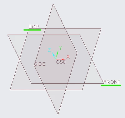

With this approach, the default, built-in, internal coordinate system is 'correct',  but you will need to swap the names of the FRONT and TOP planes so they agree with the coordinate system.

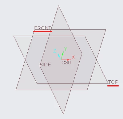

Wrong:
Correct:
It's hard to tell with this color palette, but that really is the 'negative' side of the FRONT plane.  (Which is correct since Y+ is going away.)
