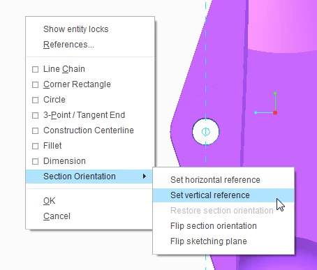

2. How do I create sketched datum points? I'm able to create a sketch
with only a few points in it, but the points don't show up as datums.

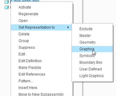

3. Somehow I've managed to get my model to be in an "unfinished state"
simplified rep, which makes me now unable to get into Mechanica... eh
sorry, "Simulate". Probably due to me using "set representation to" on
the sketch feature (in an effort to turn it into datums). What is this
"set representation to" supposed to do? How do I get into a 'finished
state'?

I’m not doing a lot of work in Creo 2 yet, but I do have an answer to #2. Starting in WF5 there are two kinds of points & centerlines in sketcher. The ‘geometry point’ will create a datum point after the sketch is complete or an axis if the sketch is used in an extrude.

2) Sketched datum points is similar to WF5 (don’t know from which version you are switching). Sketch and then use the datum point create tool while in sketcher. However, in CP2, there is only one datum point while in sketched curve. WF5 still had the two separate points (but I maybe that’s what the Construction mode is for, actually and I’m just not understanding/applying it just right).
[cid:image002.png@01CDFF86.6CE4B1C0]

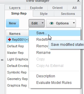

3) I’m not quite sure what you mean. I think you mean on-demand reps. If so, to save a rep, go to the view manager,
[cid:image005.png@01CDFF88.FBB4FCF0]==>[cid:image003.png@01CDFF87.1D4177B0]==>[cid:image004.png@01CDFF87.1D4177B0]

5. In WF, a user would pick the references, then pick the sketch button to be brought into sketcher. In Creo, the user is brought into sketcher, then picks the references.
