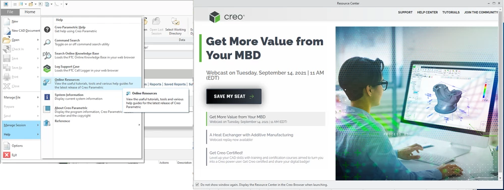

LawrenceS18-OpalAuthor
18-Opal
September 7, 2021
That sounds like what I did and it didn't work for me.  Is the custom location working for you?  When I set:
online_resources_location https://community.ptc.com/
I see essentially what you sent in your screenshot.  I get to Creo at the moment so cannot send a screenshot of what I am seeing so will try to send a screenshot when I can.
18-Opal
September 7, 2021
Here is my screenshot:
Even though I have this line in the config.pro in my working directory:
LawrenceS18-OpalAuthorAnswer
18-Opal
November 17, 2021
To summarize the answer:
  • I was using this option correctly and it was actually broken.
  • With the help of this post, it was reported to R&D as SPR 13259094 with Article summary CS354119
  • PTC Plans on fixing in following versions:
    • Creo Parametric 7.0.7.0
    • Creo Parametric 8.0.3.0
    • Creo Parametric 9.0.0.0
Thank you to all those that helped to find and correct this issue (Users and PTC).
