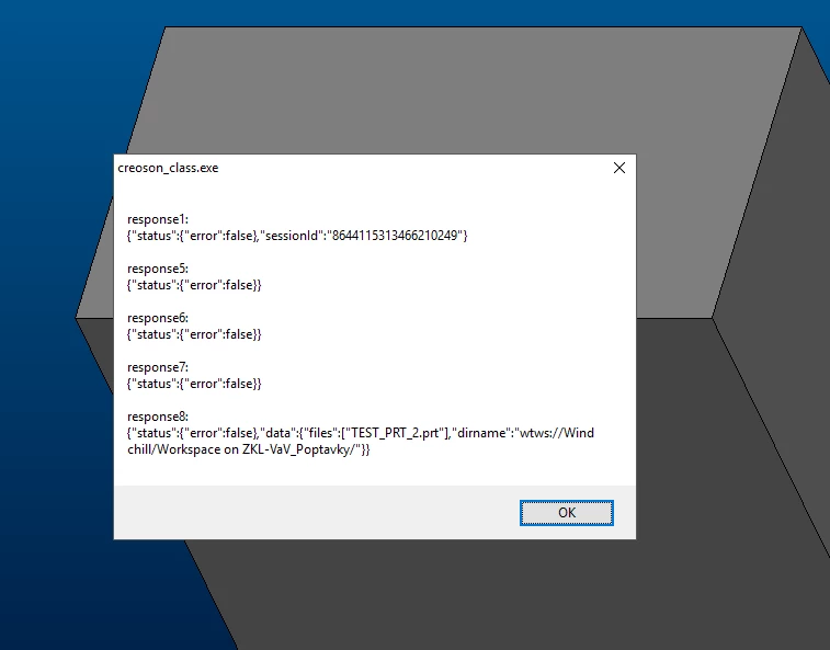

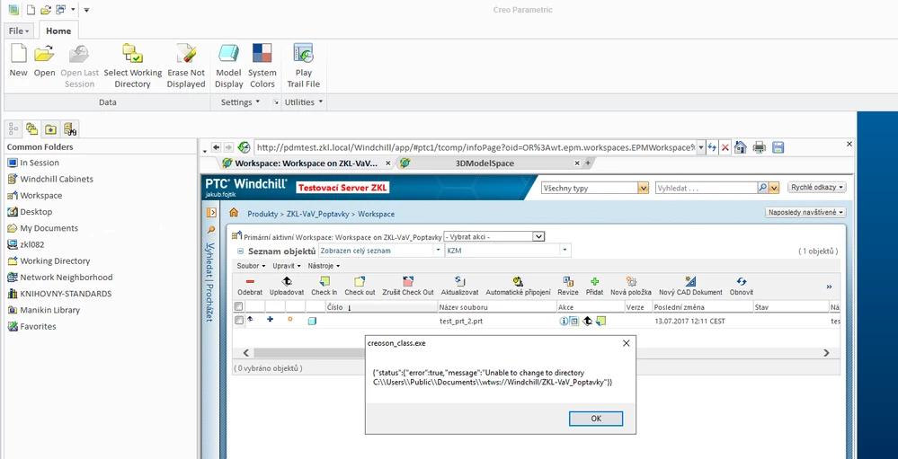

Notice the response shown from the MsgBox on line 24 on the picture bellow. In the code that is the line that says 'MsgBox, % res5',

Thank you for the reply. Finally had a chance to try what you proposed and it worked!
Solution using CreoSON and AHK follows. I added a little gui to get user credentials.

Responses:
~J
18-Opal
July 18, 2017
Sweet!  Congrats on getting that to work!
Dave
