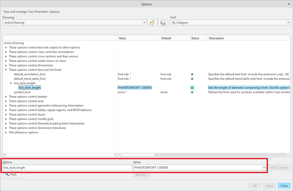

@AW_10407897 wrote:
Hi Martin,
Unfortunately. Creo 3.0 and its files are no longer accessible after the upgrade. All I have left is the old PDFs (which look identical in all respects except the length of the section line dashes).
add new option into your drawing - see picture. The value in inches represents the length of line segment.
line_style_length PHANTOMFONT 1.00000

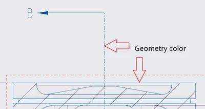

Sep 22, 2022 11:56 AM UTC
@AW_10407897 wrote:
Hello, please see attached a zip file with an example model and the PDF output showing the problem.
I am sending some information...
1.] Settings inside your drawing cause that cutting line and visible geometry edges are displayed using the same color, the name of this color is Geometry.
2.] By default Geometry color is drawn by pen 1. I uploaded 3 examples of pen 1 width.
My pentable is also uploaded (packed in zip file).
