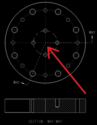

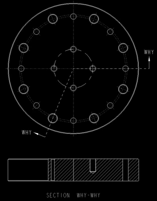

How to create this simple cross-section view correctly? (Note: the presented section view is wrong, it should be normal to its cutting planes). I know there is a procedure to make it somewhere buried in document. However, how to find this HELP is also not a simple task.
Is any kind of this problem need one day to solve?
In SolidWorks, pertinent Helps are available at one click, not like in CREO, in which I have to be well educated before I can type in the correct keywords to find a Help.

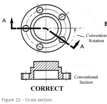

Cross-section view should be like the below. It is some sort of standard.

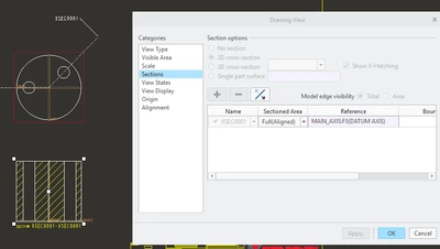

I think you want full aligned as the cross section option.

You can use Full Aligned as a projection and it is more likely exactly what you are looking for and is generally for round parts like you have.
Full-unfold may work for this application specifically but may "skew" a view in some cases.
