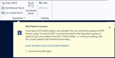

I am trying to modify the crosshatching in a part drawing section.  After selecting the area, the  "edit hatching" menu appears, but is greyed out.  Any suggestions?

Can you provide more information on the problem you are experiencing?
  • Creo version?
  • Screen shots?
  • More details?
Dale_Rosema
Jan 21, 2026 9:53 PM UTC
In Creo 10 when I click on the section:
I have this menu pop up.
I then use the drop down to select:
then it give me option to edit:
