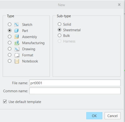

I made a part using Creo's Sheet metal with image below.
When I create an STL file and send it to our 3D printer, it makes it under millimeter only. Typically, it always ask if i want to convert to inches. When i load it into the 3D printer, it comes out super tiny and small. the problem here isn't the 3D printer, but the part itself.

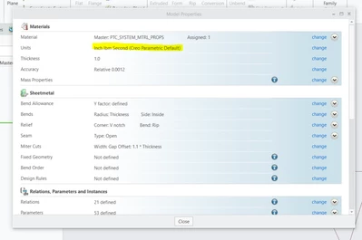

Even though i change the properties to inches/lbm/seconds. it still causes the same issue
I have a big feeling it has something to do with this axis below causing this issue:

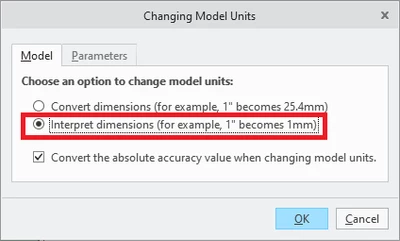

my suggestion:
  • open original model, which has set mm as lenght units
  • measure some distance in the model, for example length of some edge
  • convert length units to inch
  • measure the same distance
  • compare two measurements ... what is the result ?

I've came to realize it maybe be the template that's setup; I am unsure. when changed also, it doesn't allow it. its only when i create in sheet metal. I am clueless as of now.
