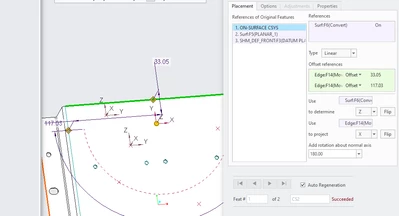

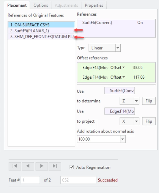

chshasa112-AmethystAuthor
Aug 16, 2023 6:01 AM UTC
hey
this solution seems not to work for me.
as you can see on the picture, i created a random sketch with several points. then i placed a csys on one of the points. but now, i am not able to place/align my udf csys with the one created on the sketch point.
am i doing something wrong or is there another possibility?
br
tbraxton
Aug 16, 2023 3:41 PM UTC
It appears that your UDF requires 3 placement references as shown in your screen shot. If you want to place the UDF using only a Csys as a reference, then you will need to redefine the UDF such that only a csys is required to place it and fully constrain the features of the UDF.
Why do you need these "extra" placement references in the UDF definition?
