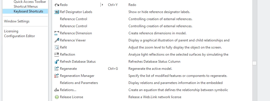

The "Keyboard Shortcuts" have been checked:

Currently it is mostly out of habit (and muscle memory) that I hit "Ctrl-G" before hitting "Ctrl-S" or before going into a family table to verify instances. But now I have to "click" with the mouse instead.
