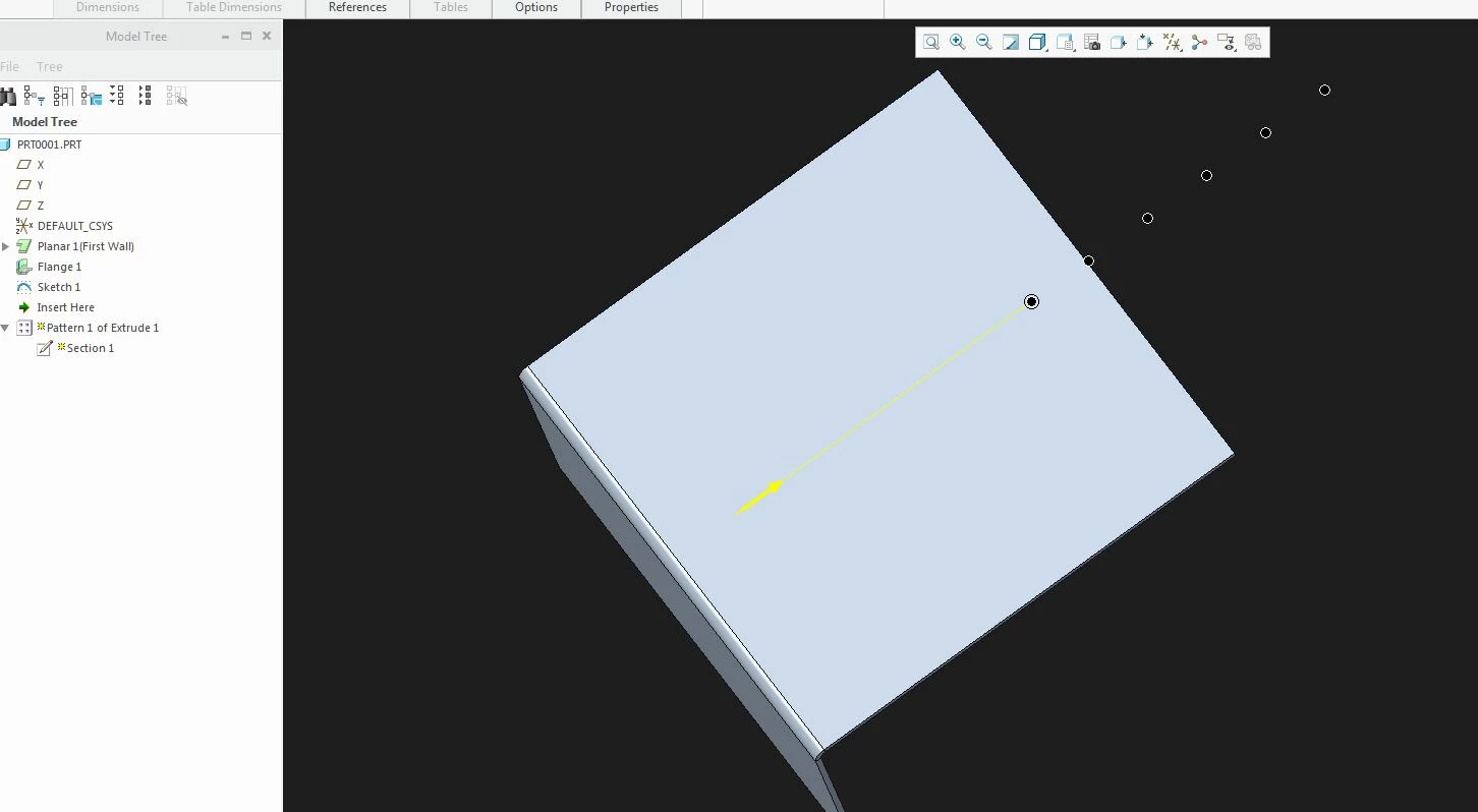

Hi all,
I have a curve driven pattern that is propagating in the wrong direction.  I rerouted my sketch to the other end of the curve and all is good - but in a more complex example, and for future reference, how can I simply flip the direction?  I checked and unchecked the option "follow curve direction" - that seemed not to affect the pattern.  I would have thought that I could click the yellow arrow, but that does not work.  Any hints?
Thanks!
-Nate

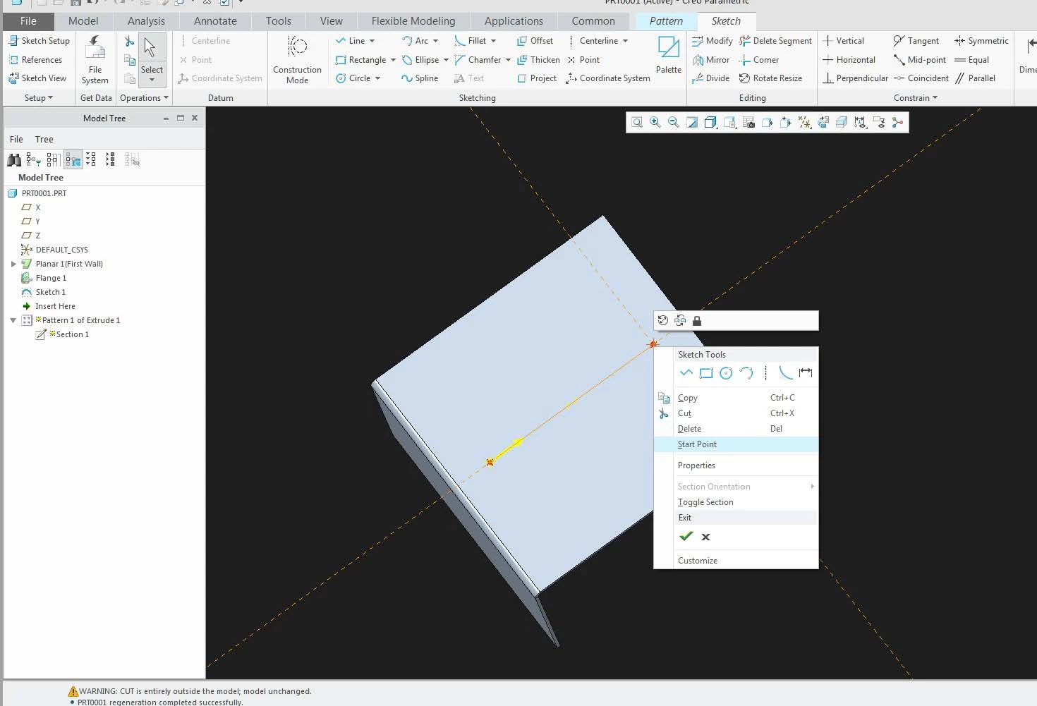

Not sure if it matters but, I usually create a stand alone sketch in the part. I then reference it in the "curve pattern" via "project" in sketcher mode. However, I am using Creo 4.0 and all I do to change the start point is <r-clik> on the end of the sketch I want to use as the origin. (see attached screencaps)

Edit Definition of your sketch that has the curve, Sketch Setup, then Flip the Sketch view direction.  This should change the direction of your curve Pattern.  (I'm on 8.0)
