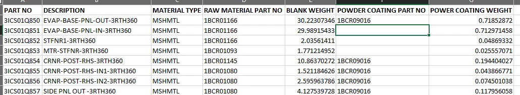

One of my creo customer is looking for a sepcific type of BOM generation in Creo drawing? Attached is the BOM format. Kindly help with a soludion. Customer has tried to use NitroBOM but are not satisfied.

NitroBOM does not interface with drawings - so that is the wrong approach doe drawing tables.  Unless you are looking to manage parameters faster using Excel via NitroBOM  or exporting the BOM to excel  then it is perfect for that ….  The drawing tables should just repeat region update when the content is included in columns.

A repeat region table in a drawing would pull the part parameters. It’s not difficult but if you’ve never done it, it will take a little time to understand.

If the individual parts have all of those fields shown in your example as parameters, then creating a drawing BOM table identical to that can be done. Follow the items in the link Stephen provided for details.
With Repeat Region relations, you can even filter out certain information if it is not needed in the BOM.
