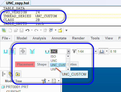

Did you defined THREAD_SERIES in new file? Check below image, I defined THREAD_SERIES in new file as UNC_CUSTOM, which was populating when inserting hole (Need to relaunch Creo).
