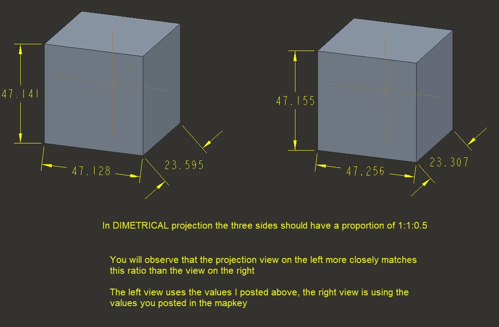

I am posting this for reference only. You will see that the angle values I posted above more closely match the target ratio of the projected lengths. One is left to determine what is good enough for themselves. Neither of the angle values result in the exact ratios of the projected lengths.
tbraxton
Apr 7, 2025 4:04 PM UTC
I think you may be off (slightly) on the values you are using for dimetric projection. In practice this would not be spotted in most applications. If you use something like Mathematica or a scientific calculator, I think you will find that you get the values below for the Dimetric angle equations rounded to 3 decimal places.
In DIMETRICAL projection the three sides have a proportion of 1:1:0.5
DIMETRICAL 3D views based upon a vert. angle of -20.705 (= ArcSin( Tan (ArcSin(1/3) ) ) degrees and a horiz. angle of 19.471 (= ArcSin(1/3) )

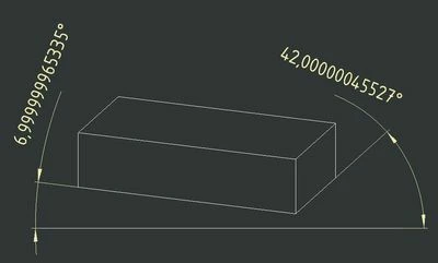

IVsergiu4-ParticipantAuthor
Apr 10, 2025 11:47 AM UTC
The formulas I've posted are correct.
Bellow I've attached a picture from a drawing, where the calculated angles are almost the standard ones (it depends on the number of decimals for the input angles when the view is created)

Apr 10, 2025 12:37 PM UTC
