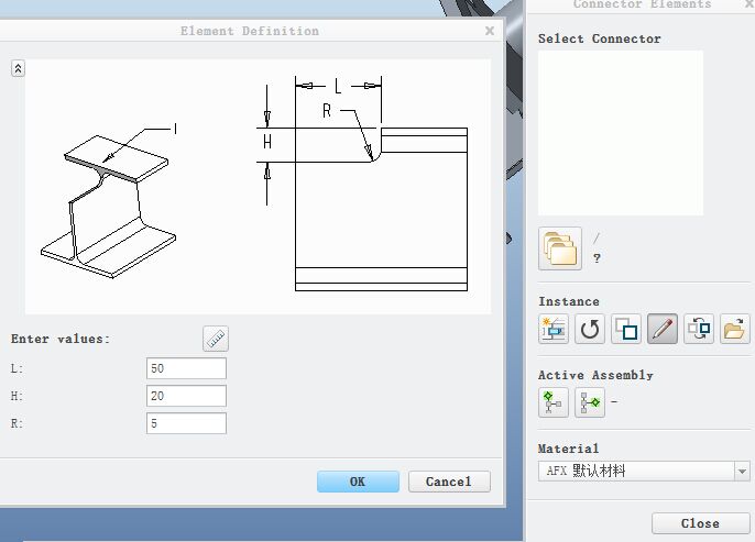

We can very well use three udfs for design and modify variable dimensions via menu  of  "modify connectors element" ,
Variable size value can be updated automatically.

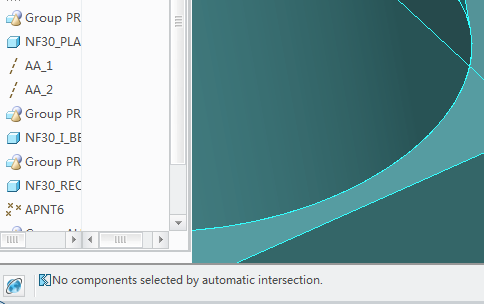

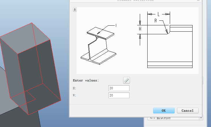

Then, we can use this udf loading into part file in afx,  but if we modify this udf via menu  of  "modify connectors element" ,
The message bar prompt  "No components selected by automatic intersection",
Variable size value cannot be updated automatically
WHAT HAPPEN ?

this message is not created by AFx but by Creo itself. It Looks like you are trying to create an UDF with a cut Feature in an assembly model (not in a part model).
Does the surface you select as PLACE_SURFACE belong to part or to assembly?
If you do not get it working you can send UDF + tab-file + model to test + short description of picks how to reproduce issue to me then I can check
stefan@buw-soft.de
Stefan
