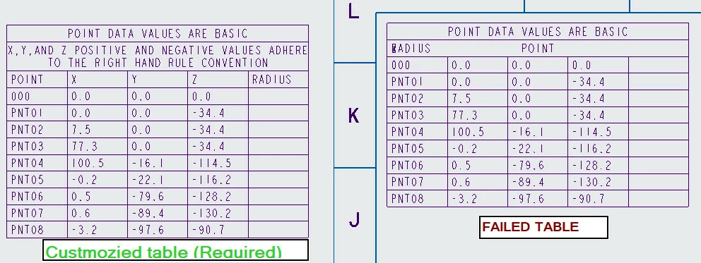

customized Hole table through datum points failing after updating (Creo 10)
I am creating hole table from points and customized the table according to requirements i,e added some rows but after putting table on drawing when it is need to update by clicking "UPDATE TABLES" it failing all added rows are failed not showing properly .
Kindly help to resolve this issue or how can we customized the hole table according to our requirements.
Please see attached snaps for reference.
Dec 19, 2025 10:07 AM UTC
AFAIK hole table is generated automatically. When you do some manual modifications and update it then Creo recreate it and your manual modifications are gone.

It will failed anyways still we update it or not it will failing automatically ......any solution will be helpful 🙂
Dec 23, 2025 8:32 PM UTC
in my opinion, there is no solution.
