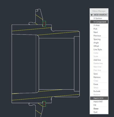

In Creo 4.0 I was able to cycle through different hatched components in an assembly drawing with the "Next" and "Previous" function in the Mod XHatch menu.

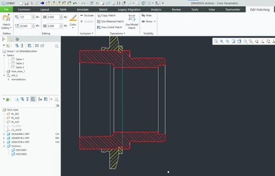

However, in Creo 11.0 I cannot find this functionality in the "Edit Hatching" menues, How can I cycle between hatched components in an easy way?

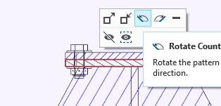

I tried it out in Creo+ (12.0), I usually use 7.0, and found that selecting on the screen seems to be the only way to change.  However, this also gives the basic modification tools needed in the mini tool bar.

Many thanks to you all for the response. The video was very helpful, thank you for that Martin.
I also found that I could select the part in the Assembly Model tree and cycle through the components / hatchings with the Up and Down keys.
