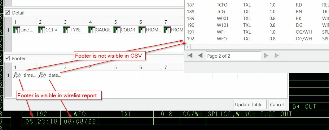

I'm looking for a method to insert a visible date stamp into a wirelist so that a reviewer can quickly verify when the wirelist report was generated. This datestamp needs to also be present in the CSV so that the datestamp is available when the CSV is exported.
A datestamp can be added to the footer, but this footer does not get transferred to the CSV file (screenshot 1).

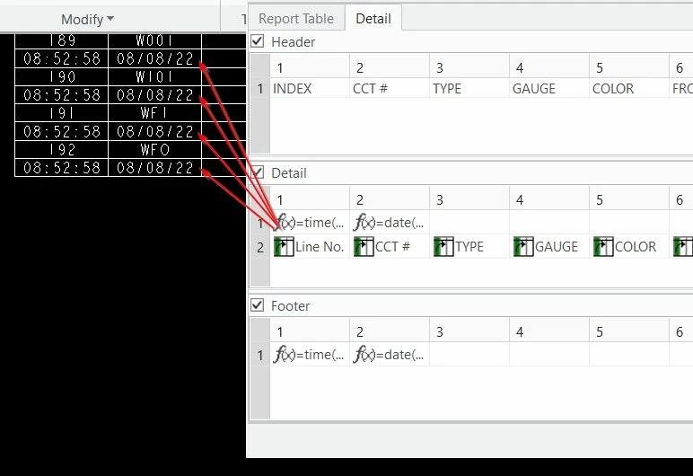

If a row is added to the table with a datestamp, this row is repeated between every line, which is not the desired result (screenshot 2).
Has anyone found a solution for this? It would be ideal if the footer would carry through to the CSV but this does not seem to be an option.

CSV (like any file) have time stemp, so you can know when it was created .
adding date/time in table is paworefull as it will show you when the last time the table was update ... but tables can't be exported as CSV .
