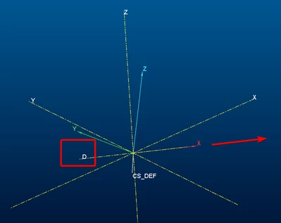

I have to create three Datum Axes with name D, E, F, based on a custom Coordinate System ("CS_DEF"), which is rotated relative to the original (XYZ) coordinate system.
My problem is that, if I create a Datum Axis based on the axis of the coordinate system, Creo puts the axis name on the opposite side of the direction of the coordinate system's axes.
How can I move the name of the axis to the opposite side?

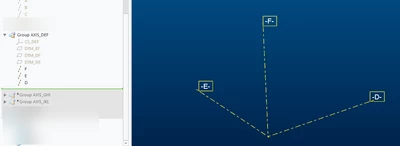

Feb 28, 2025 1:22 PM UTC
I got a lot of useful ideas, and in the end, one plus one idea became the most useful for me 🙂
  1. Creating CSYS based on the default or previous CSYS (easy to set the origin and orientation)
  2. Define 3 planes based on the new CSYS's axes
  3. Define 3 datum axes based on the three new planes, setting their size
    The selecting order of planes affects where the label is positioned on the resulting datum axis.
The positive sides of this method:
  • Sketch references and mates refer with the correct name of axes
  • I realized afterwards that I should have used the created planes for sketch anyway
Created objects: CSYS, Planes, Axes
After hiding CSYS and planes, clear and nice:
Thank you everyone for help.

Feb 25, 2025 3:55 PM UTC
Yes, I understand you, the question arose because the axes of coordinate systems cannot be renamed.
I have to use ABC, DEF, etc coordinate systems in the model and also I have to see names and the (positive) directions of the axes. I tought the simplest solution to this would be to have the axis letter visible in the positive direction

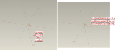

StephenW
Feb 25, 2025 4:11 PM UTC
I think that an axis does not have a positive or negative direction.
StephenW
Feb 25, 2025 4:33 PM UTC
@NG_12013596
Axis creation is amazingly consistent though. Using my default coordinate system, I recreated the same thing you did.
So I created another coordinate system, with the directions different from the default. I created a new axis for the coordinate system and the axis labels are on the other side.
So, if you can stand to have another coordinate system oriented differently, you can get your axis labels on the other side.

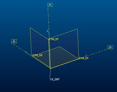

NG_1201359610-MarbleAuthorAnswer
StephenW
Feb 28, 2025 1:34 PM UTC
@NG_12013596 Nice solution...don't forget to mark your response as the solution.
Out of curiosity, I tested the axis creation based on datum selection order...it's a nice trick to get the label where you want it. I don't know where I can use it but it might come in handy one day!
