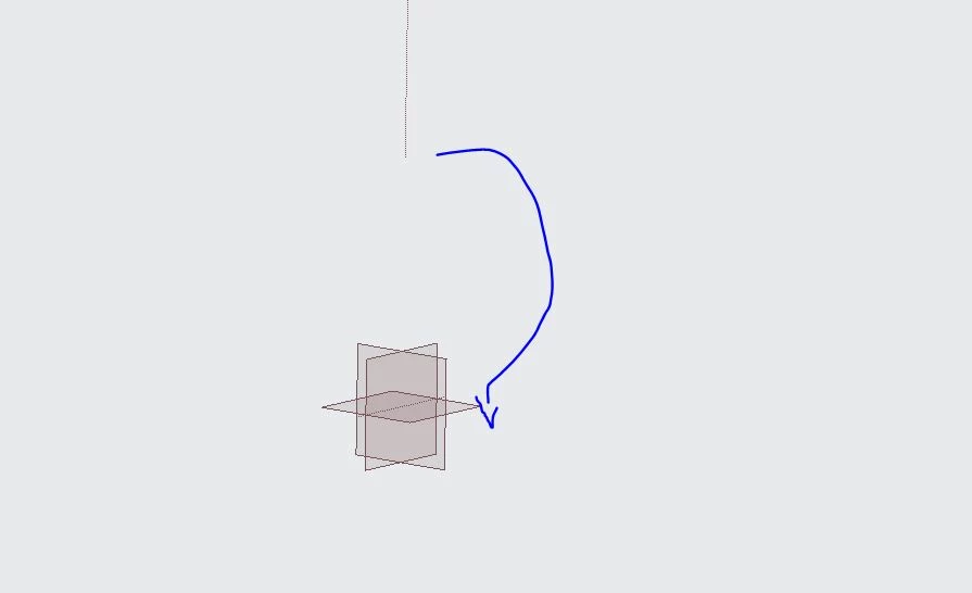

Hello Dear members, I am trying to place publish geometry in part using Copy Geometry in Creo 8. The publish Geometry is simple axis created with the help of two datum planes. This Axis in not visible in Copy geometry feature. Could someone help with what am I missing here? Will appreciate you reply. (Note: Datum display filters are all ON)

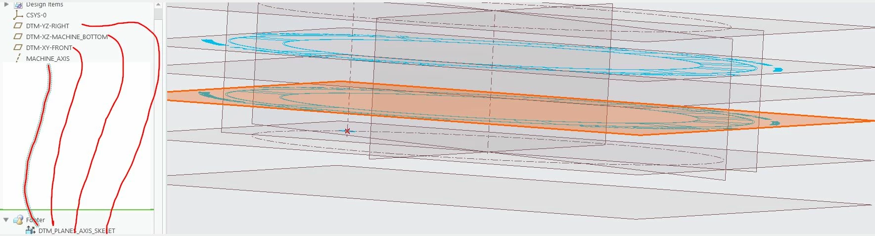

umg10-MarbleAuthor
April 1, 2022
Thank you @remy  and @sacquarone really appreciate you reply. I figured it out may be its an display issue. In images you can see that the axis is not passing through the planes that I used in its creation. When I did Copy geometry and refit the screen the axis was not visible due to its location far away from the planes which I used to create it. The axis might be readjusting to other planes size, is there any settings to adjust Axis display automatically to make it pass through and readjust to all planes? (I know we can manually adjust Display in Axis Edit definition). See attach to get idea. Thanks
