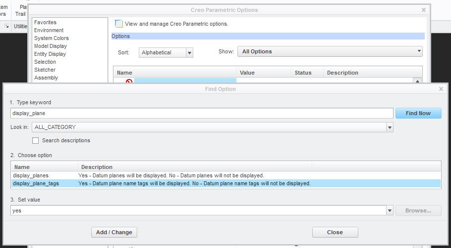

Dear Community,
I am a fairly new user and have seen the datum names on the planes in the model - i,e on the model, the 'top' 'right' and 'front' planes are named so it is easier to select them.
I managed to turn these on once but can't find how to turn them back on again.
Thanks for the help
May 12, 2014
In file - options - Configuration Editor - search for display_plane_tags option and set it as "YES", or this can be done in your config.pro file add a line as display_plane_tags yes..Capture01.JPG
