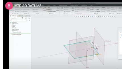

I am new to creo and I was wondering if it is possible to make my datum planes not transparent anymore.
Now if I select a plane just the border changes color. But I want the entire plane to change color.
Can somebody help me?

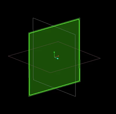

mkajdanAnswer
Mar 14, 2023 2:07 PM UTC
File
Options
Entity Display
mkajdan
mkajdan14-AlexandriteAnswer
File
Options
Entity Display
