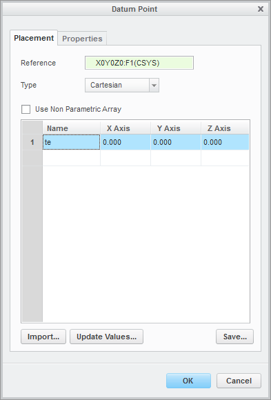

I seem to have found a weird bug in Creo 3.
If I create a Point Offset Coord System, whenever I enter values into the table, after two keystrokes the system accepts the value and stops me typing any more!
Therefore, if I try to name a point "test" I get "te"; if I try to enter a value of -830 I get -8.  I have to re-edit each cell to complete the value.
Can anyone else replicate this?  Doesn't seem to happen in a comparable Creo 2 install.
StephenW
December 1, 2016
Haha, yup. Creo 3 M070 does this.
Click on it again and then click just the last letter so you are "adding" more text and it lets you continue with longer names.
