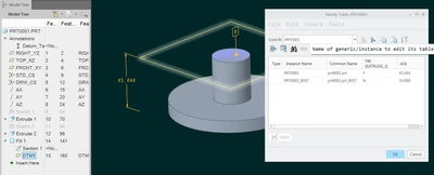

Well, I "faked it" by attaching the datum tag to a surface:
Generic:
instance:
This construction fill surface was then hidden away.  You should also add some relations so it follows the relevant feature sizes.

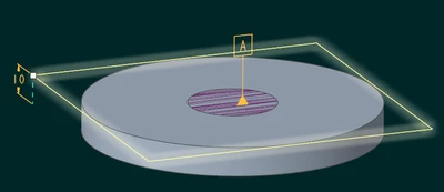

@sundoopi , are you trying to accomplish this:
generic:
instance:
sundoopi1-VisitorAuthor
yes!
pausob19-TanzaniteAnswer
Generic:
instance:
Hello all,
thanks for your answers. It looks, that we have to trick the message center with a "faked datum plane".
