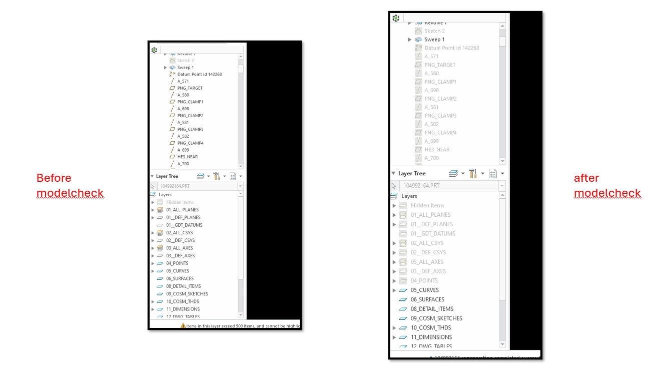

Datums in Model tree being hidden when i run model check
when i run model check all the datums (planes, points, axis, curves) all become greyed out in the model tree and layers. i do not want this i want to see them at all times. i have been told that this is a default setting in Creo from PTC. is there a setting i can change for this?
Nov 15, 2024 6:22 PM UTC
What version of Creo are you using?
That is not a Creo setting, but might be how your company has ModelCheck configured. It does not do that with our settings in MC.
JGUERNSEY4-ParticipantAuthor
Nov 15, 2024 6:26 PM UTC
we are on Creo8, going to 10 next year.
ok, i asked our Support person about it and he told me that it was a PTC setting that they could not change. i will get back with him about this again.
thanks for the feedback.
