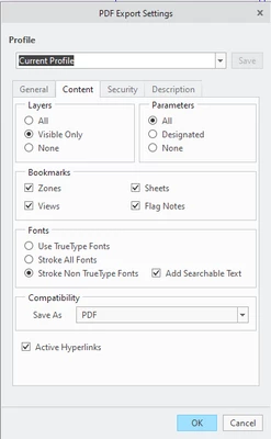

Look at the content tab.  All of the items checked add more information to the file.
