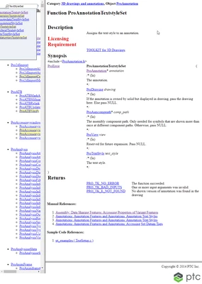

    here is about Creo Toolkit, you can use the function ProAnnotationTextstyleSet().
    A code example is available with TestSetup.c in pt_examples.
    Here is an example used on a dimension: https://www.ptc.com/en/support/article/cs325206
    And similar solution but for a drawing note: https://www.ptc.com/en/support/article/cs360235
    and finally some code to create a FTS note: https://www.ptc.com/en/support/article/cs80810
    Combining all those you'll be able to create a FTS note and set the text height at creation.
