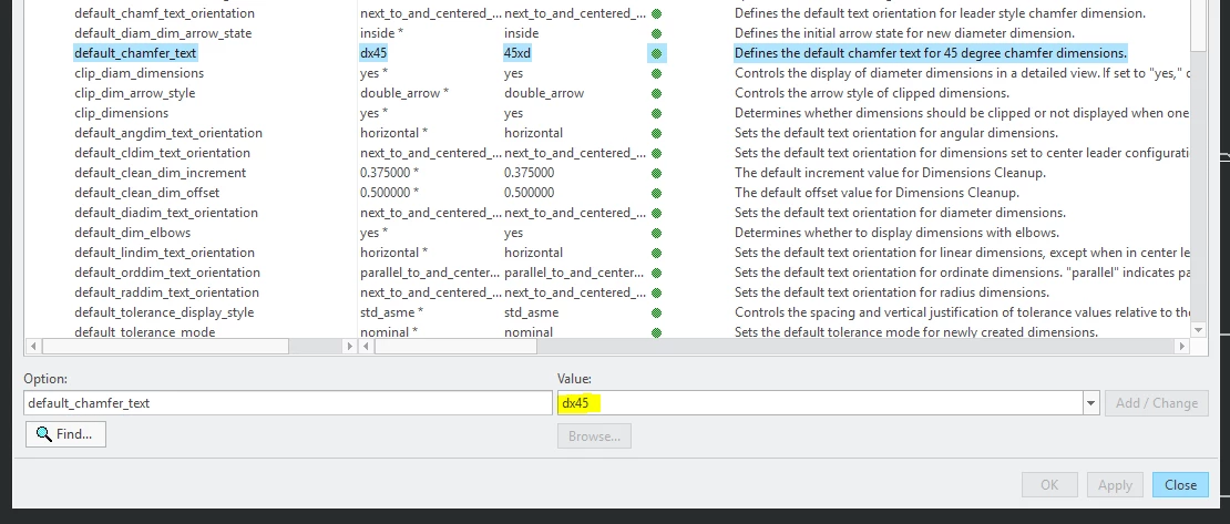

default_chamfer_text dx45
When choosing the "dx45" value, the text orientation seems off.  The "X" is not capitalized and the spacing between the characters is not correct.  See "45xd" for how it should be (when it comes to capitalization and spacing).
I knew it wouldn't work, but I changed my drawing.dtl so that the value for that command option was specifically "d X 45".
Is there a fix for this or is it a bug that PTC would have to look into?

Long discussion here but the bottom line is Creo 4 M020
https://community.ptc.com/t5/Creo-Ideas/Fix-45-degree-Chamfer-Text/idi-p/466513

Thanks!  Is there an updated release date somewhere?  June has come and gone.
https://community.ptc.com/t5/Creo-Modeling-Questions/CREO-4-0-M020-to-be-released-in-June-2017-soo-late/td-p/403136
StephenW
Jul 18, 2017 1:22 PM UTC
I'm pretty sure it was released on (or about) June 27th.
I can't look since my admins have disabled users from the ptc download page.
https://support.ptc.com/appserver/cs/software_update/swupdate.jsp
