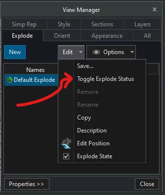

In the view manager, you can select the "Edit" drop down and click "Toggle Display Status".

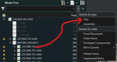

Then in the dropdown next to the Model Tree filter bar, select "Parts"
Then, starting at the first part, shift select the last part on the tree so every part is selected. Click "done". This will reset everything the position of every part in the Default Explode.
