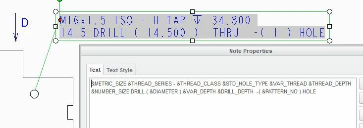

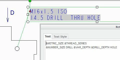

If you use a standard threaded hole from the drop-down list in Creo, M16x1.5 for example, then on the drawing sheet you can show the dimension as an annotation (Annotate > Show Model Annotations).
Modify the standard text to provide your required specification.
Note: M15x1.5 is not an option in this case because the Creo drop-down menu for standard threaded holes only contains ISO preferred sizes.
