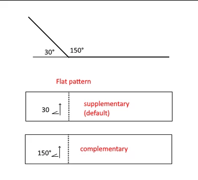

Define complementary angle on flat pattern
how to set and make default complementary angle when creating flat pattern view?
Software version: Creo Parametric 6.0.5.1
Thanks in advanced!

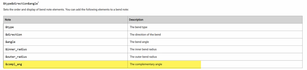

There is a sheet metal config option that can be set such that the complimentary angle is used for bend notes.

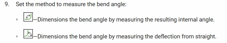

FYI: There is an option to do this when creating a bend with a surface reference. Refer to step 9 in the following link.
To Create a Bend with a Surface Reference (ptc.com)

Mar 4, 2024 11:50 AM UTC
Thank you very much! It works!
