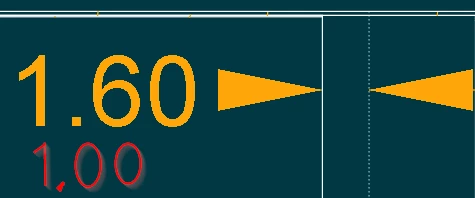

Hi all, I'm hoping someone can help me out with this seemingly simple task.
I'm adding sketch lines to a finished 2D drawing to mark where custom cuts must be made.  How do I define the dimensions of the line, such as creating the sketch line 1 inch away from a predefined part view line?  I can snap to those lines, but I can't define a simple dimension for the distance between the two lines, or even the length of a sketch line??
