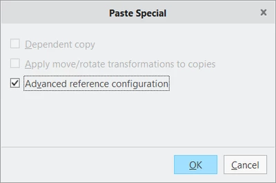

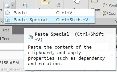

If anyone else is wondering or looking for a similar functionality.
We found groups to work quite well.
You can copy a group and when using paste special with Advanced reference configuration to work very well. In there you then only have to re-define the constraints which are set to outside the group components. So, it allows re-using groups, while defining usage attributes such as Reference Designator per item. Further of course you can also pattern groups within an assembly.
