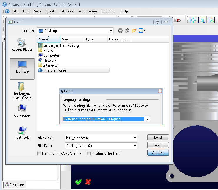

November 15, 2010
Started Modeling PE 2.0, opened the load option dialog, and try to find that option:
