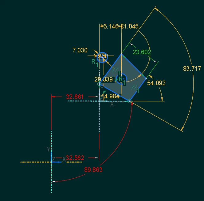

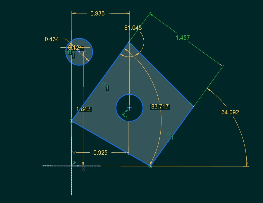

I can't quite picture what you are trying to streamline, but are you saying that dimensions and constraints in your saved .sec sections are gone when imported into a new sketch?  Like I said, my system makes weak dimensions to the .sec coordinate system when importing the section into new sketch:
.SEC file (with a local construction coordinate system).SEC file (with a local construction coordinate system)Section imported into a new sketch (which contained only a geometry coordinate system)Section imported into a new sketch (which contained only a geometry coordinate system)
(color scheme: locked orange, strong green; weak red)
(also note the orientation of the coord system in the .sec file was not constrained - hence 3 weak dimensions upon import)
Anyway, if you can, why not submit your enhancement request.  Are those different from the "product ideas" that this community forum can vote on?
