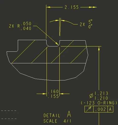

Creo 4 Drawing - Is there a way to add a datum and plane to a clipped dimension shown on a detailed view without using a draft entity line to show the plane?

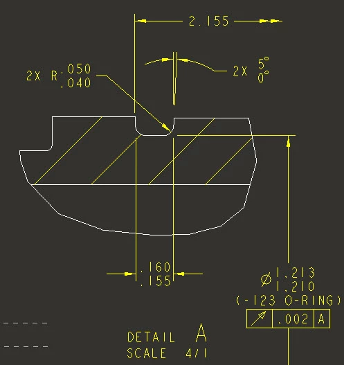

The first picture is what I have.  The second picture is kind of what I want except the white line is a draft entity just related to the view.  Is there a better way to do this to indicate the 2.155 dimension origin is datum E?

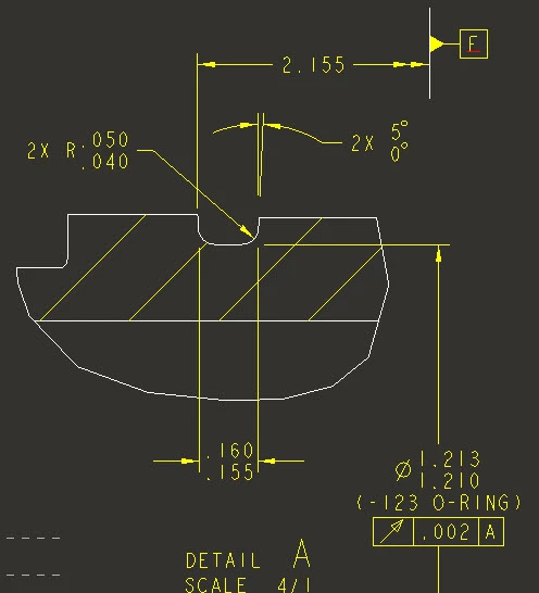

Follow up question.  My datum E in this view was created via the datum feature symbol, notice the red line below my datum E.  This indicates that it is a duplicate tag, which obviously it is because the original datum E is shown on the main view.  Do I just accept the error (red underline) and move on, or is there a way to avoid this error?
Cheers
Airfix
September 19, 2021
I have similar issue. I need duplicate some datums to clarify the print, but Creo underline to indicate that is wromg. The ASME permit to duplicate the datums.
PTC, please, remove this undeline and add a tip ballon to indicate it.
