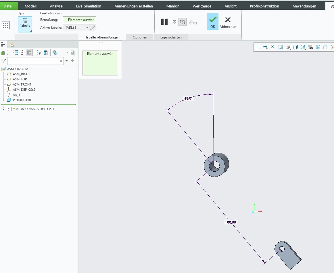

Determine angle by using Table Pattern in Assembly
Why isn't it possible to determine the angle using the table pattern?
If possible, how can I make it work?
The 40° in the picture.

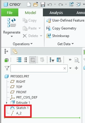

I added two features into prt0003.prt ... see following picture

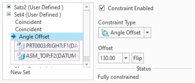

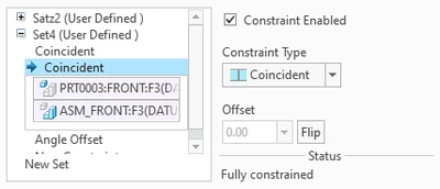

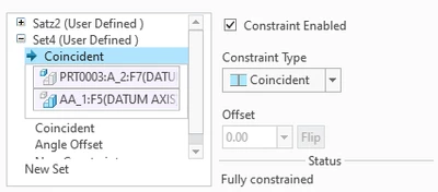

I changed assembling constraints related to prt0003.prt ... see following picture
I disabled Satz2 constraints and created new Set4 constraints.
