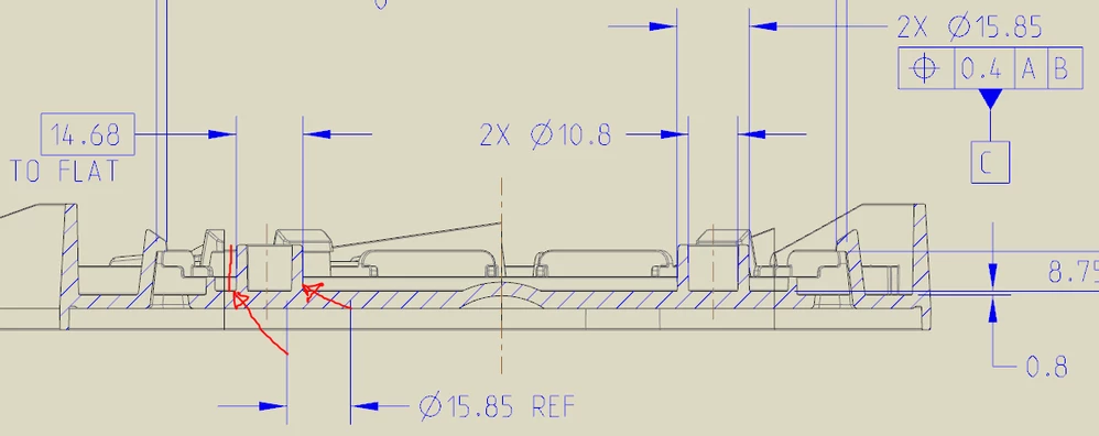

8-Gravel
March 12, 2022
The following is my revolved section view, experiencing same problem with Creo 4.0
the 15.85 dia shown dimension on the left should be on the extruded boss like the other one on the right.
The dimension don't even align with the parent view geometry.
My work around for this is to create a construction entity and dimension as a linear entity and slap the diameter symbol on it.
