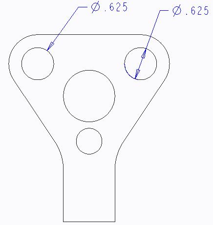

Is there a Drawing Option setting that would allow the default diameter leader to be the single outside point (like on the left) instead of the double inside (like on the right).
Currently, we have to double click and then middle click to create the .625 dimension, then you have to deselect, left click to re highlight and right click to flip the arrows.  90% of our diameter dimensions end up with the single arrow, so we would like this to be the default config option.

I am not sure about the config option but with the following method you can reduce the number of clicks
1. Select all the dimensions using the  smart window selection for dimensions ( it will select only the dimensions covered by the window)
2. Right click on the screen and select "Flip Arrows"
3. All diameter dimension will be as per your requirement

There is a setting in the drawing.dtl for this… default_diam_dim_arrow_state   single
KenFarley
Jul 15, 2026 8:53 PM UTC
This is a ten year old inquiry. The drawing file option has been, as far as I can tell, in place since Creo 4. It’s always been and still is a hidden option, though, so the only way people could use it is by manually editing their drawing.dtl file. Being hidden also means there’s no “official” documentation that I can find telling all the options.
