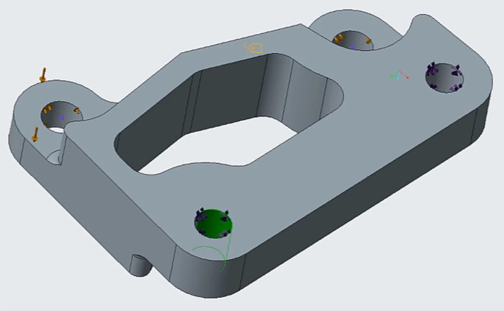

The highlighted hole can be removed while in Creo Simulate.
Remove a Feature Within Creo Simulate
To remove a feature within Creo Simulate:
  1. Using Creo FMX, highlight the feature you’ll remove.
  2. On the Refine Model ribbon bar, click Remove.
  3. Preview and/or Accept the change.

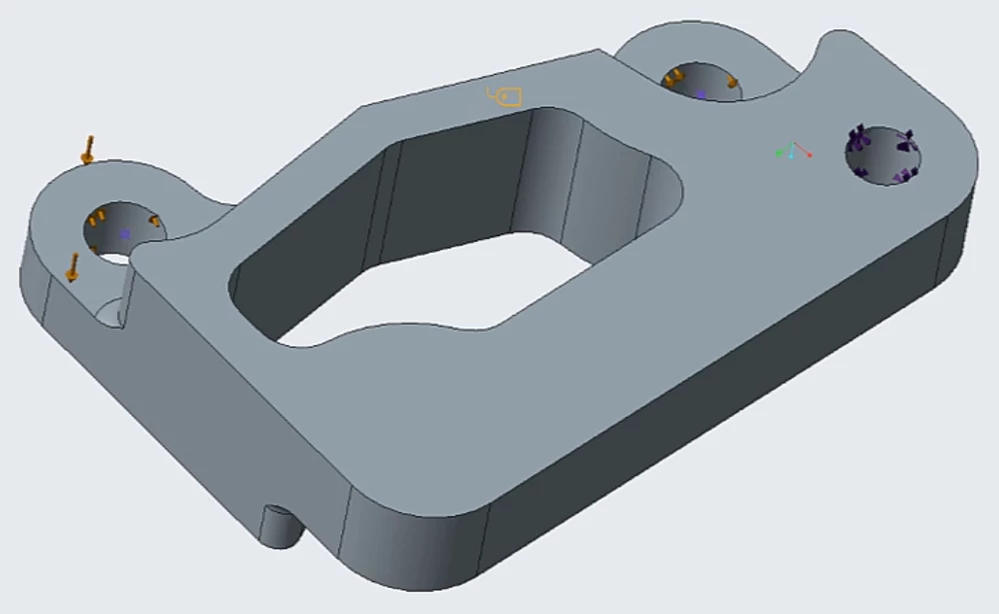

It’s important to note that currently the change is only applied in Creo Simulate. You must promote changes made in Creo Simulate to apply them to the parametric model. To promote a change:
  1. In the Model Tree, expand Simulation Features.
  2. Right-click the removed feature and select Promote.
The highlighted hole (shown in the image above) is removed.
