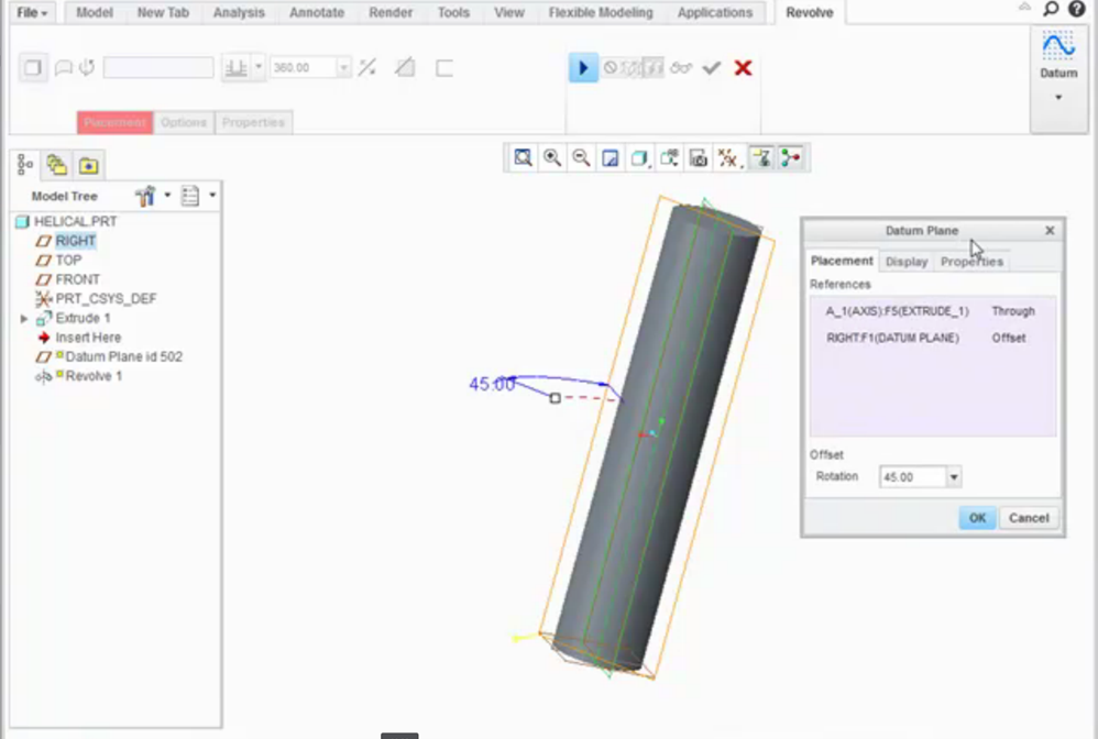

Step 1: Create a Sketch Plane on the fly
The secret to making the helical pattern is in how the sketch plane is set up for the feature that you want to pattern. The dimensioning scheme for the sketch plane must support the pattern that you want to create.
We will pattern a spherical cut which we will create with a Revolve feature. To begin, select Revolve and invoke the datum tool to create a datum plane on the fly.
Create the plane through the center axis of the cylinder and at an angle to one of the datum planes. The angular dimension will be used by the pattern as a dimension to increment when making subsequent instances, so the value here isn’t important, except for the placement of the first pattern instance. Accept the default value of 45 degrees.
Image 1 for Did You Know 9.Helical Pattern.pngCreating the plane after invoking the datum tool

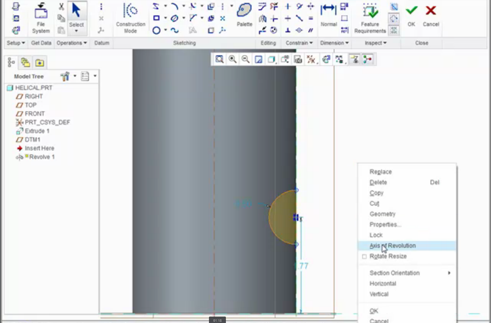

Step 2: Create the Revolved Cut
Resume the Revolve tool. The datum that you just created will be used as the sketch plane for the Revolve. In Sketcher, select References and capture the silhouette edge of the cylinder as a reference.
Next, using standard Sketcher workflows, create the half circle for the spherical cut at the edge of the cylinder. Create a Geometry Centerline along the edge of the cylinder for the half circle to revolve around. Designate this centerline as the Axis of Revolution.
Complete the Sketch, and select the option to Remove Material from the Revolve dashboard to make a cut.
image 2 for Did You Know 9.Helical Sweeps.pngAfter creating the half circle, create a center line which will serve as the axis of revolution

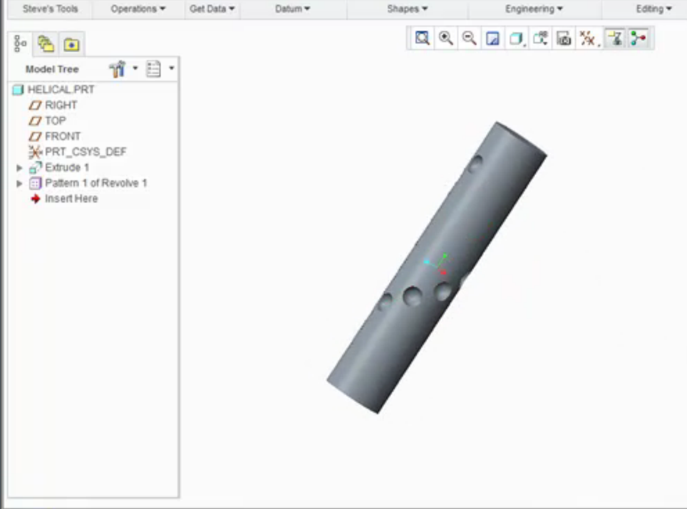

Step 3: Create the helical pattern
After creating the first cut, you will have the dimensioning scheme needed to create the helical pattern. We will define the pattern to increment two dimensions in the same direction.
Select the Pattern tool for the revolve feature and open the Dimensions tab. Select the 45 degree dimension to rotate the feature around the shaft, and set the increment to 45 degrees. While holding the Control key, select the linear dimension from the end of the shaft to pattern the cut along the length of the shaft. Set the increment appropriately for the shaft size.
Finally, enter the number of instances you want to have in the pattern and complete the Pattern feature.
image 3 for Did You Know 9.Helical Sweeps.pngThe final product: a helical pattern on the side of a cylinder
