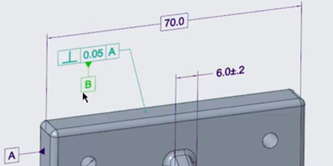

If you are deploying model-based definition in your company, you’ll want to download Creo 4.0. We’ve added dozens of enhancements to the software specifically to improve MBD. Among these new capabilities, we've made it easier than ever to create datum feature symbols. Now you can quickly create datum feature symbols anywhere you want, with smart, standards-based placement options that follow the latest GD&T standards. Our expert has the details.annotation-trimmed.jpegWorkflows for creating and editing datum feature symbols are more intuitive.
Datum feature symbols can now be created as a stand-alone annotation and do not require a plane or axis in the model.
When you create a datum feature symbol, you can immediately see it in a preview attached to the mouse pointer. You can drag this preview to select the placement location.
Dragging a datum feature symbol for placement.
There are multiple standards-based placement options which conform to the latest GD&T standards.
Once you have placed the datum feature symbol, the Datum Feature tab appears. Use the options available on this context sensitive tab for editing properties of the datum feature symbol.
Opening the Datum Feature tab to change properties for the selected datum feature symbol.
When you select the datum feature symbol, the Datum Feature tab opens automatically. When the datum feature symbol is no longer selected, the datum feature tab closes automatically.
You can modify the placement of the datum feature symbol by dragging it.
Dragging a datum feature symbol.
If you place a datum feature symbol on a GTOL, you can choose whether it attaches to the GTOL frame or to the leader by choosing the option from the right-click menu.
Right-click to open the context menu and select the option to place the datum feature symbol on the GTOL elbow.
Similarly, if you place the datum feature symbol on a diameter dimension, you can choose whether it attaches to the dimension elbow or to the dimension line opposite the dimension text.
Right-click a datum feature symbol on a diameter dimension to open the context menu and move the symbol opposite the dimension text.
To see a demo of these features, check out the video: https://youtu.be/yULd7Dl5fcA
You can also learn more by reading the PTC Creo Help Center page, More Intuitive Workflows for Creating and Editing Datum Feature Symbols in Model-Based Definition.
If you haven’t already, download the software here and try it yourself. And stay tuned to our “Did You Know” blog series, as we cover more enhancements in PTC Creo 4.0.
