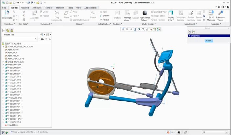

Step 1:
First, define the ground body by selecting the curves that define it. The selected entities are automatically copied to the skeleton body as an external copy geometry feature. You can add more skeleton bodies using the same process.
Adding skeleton bodies after defining the ground body by selecting its curves

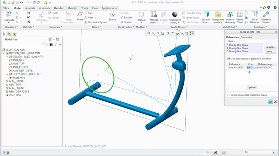

Step 2:
Once again, select the entities that define the body. Click Update and the system automatically creates the potential connections according to the identified intersections of the curves that define the bodies. You can always change the definition of a switch to classic positioning mode. Let’s go ahead and define the rest of the bodies.
After clicking Update, the system automatically creates the connections

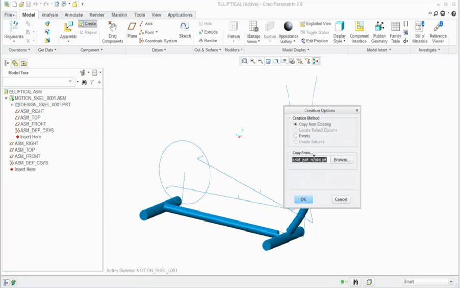

Step 3:
After we identify all the bodies and connections, the mechanism is now functional in the skeleton level. You can even perform a kinematic analysis in this early stage before designing a single part.
The functional mechanism at the skeleton level.

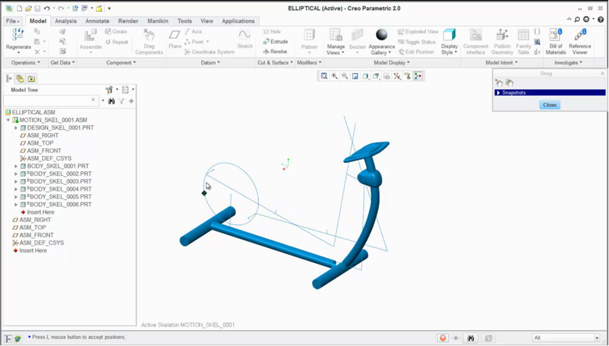

Step 4:
Time to start designing new assembly parts! When creating new parts, select Attached to Skeleton Body. This will place the new part on the same coordinate system of the selected body. It will also automatically populate the new part with a merge feature that contains the entire geometry of the selected body.
We can open parts and add detailed design around the entities that came from the top skeleton.
After a short while, we get a complete model that materializes the original design intent into a smart, fast, and automated top-down design.
The final model: a smart, fast and automated top-down design.

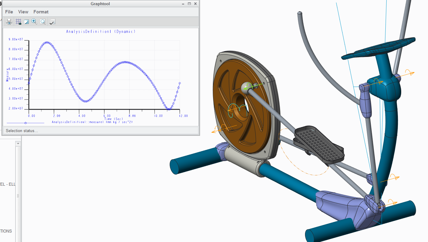

February 18, 2014
BJ P,
You can definately get reactions forces on parts that are attached to skel bodies since ridigly connected bodies behave like single kinematic body. So you use same motion axis (in this case - the one in the motion skeleton) and get the reactions you want on the attached parts.
For example - here's reaction forces on one of the joints to the leg platforms:
As for evoloving the design - Motion Skeleton allows you to create and evaluate very quickly different mechanism ideas.  You can always update the bodies by redefining them and re-evaluating connections.  Of course if mechanism layout dramatically changes - you may need to redefine many of the skeleton bodies. That is far mroe efficient to do so ealy on in skeleton stage, than when having fully details mechanism parts already designed.
-Moshe Baum

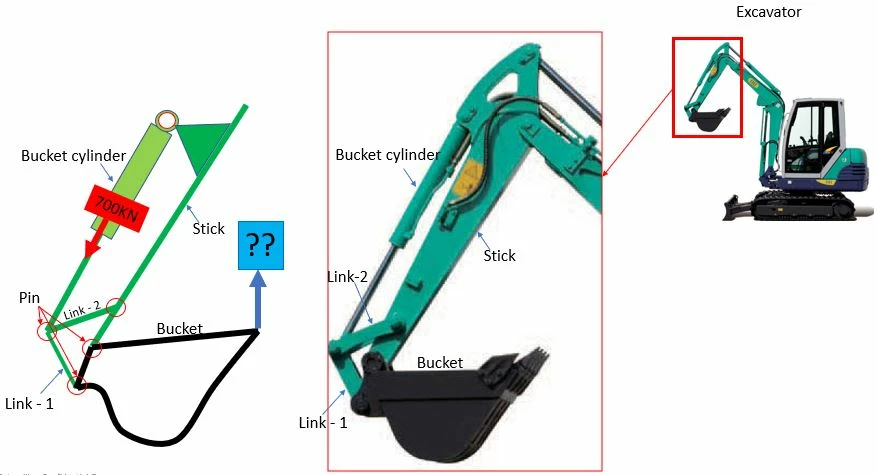

March 25, 2019
Hi TMCKEOWN,
I am going to calculate the bucket available force as showing image (Bucket cylinder force we know 700kN) without creating all linkage parts because it consume lot of time to create the parts. It means it is possible to calculate force thought skeleton sketch?
Following Force need to calculate
Max available Bucket force
Max available Link -1 force
Max available Link -2 force
