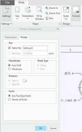

Hi All,
I have set a font for drafting but while taking the print outs the font is different from what i see in the system, what is the reason behind this.Can someone help?
Thanks in advance,
Laiju Yohannan
kdirth
October 8, 2019
The font is not supported by the printer.  In the print settings, select "Stroke all fonts" on the Printer tab.  This will send your font to the printer as lines, not text.
