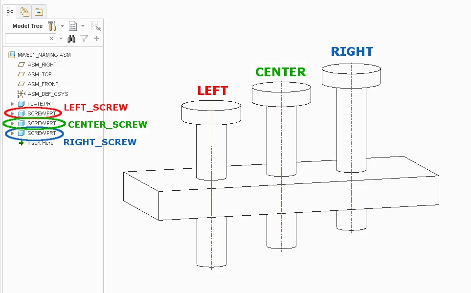

Let us say I have two parts: a plate with three threaded holes (PLATE.prt.1), and a screw (SCREW.prt.1).
When I assemble these parts together, I will set up the PLATE.prt.1 as default, and I will assemble three SCREW parts in it.
The Model Tree to the left of the screen will show PLATE at the top, and underneath three SCREW parts, all having the same name (I have put together a Minimal Working Example file).
I want to change the Model Tree to show:
PLATE
- LEFT_SCREW
- CENTER_SCREW
- RIGHT_SCREW
(or whatever naming convention the system allows) -- please see image attached.
Can I do that in CREO 3.0 or do I have to duplicate the SCREW part file in three distinct files, and then assemble them as different parts?
I just want to know if there is a possibility to give the same part, used repeatedly, a different name under CREO assembly Model Tree.
Or mark it somehow differently, even without it being visible, like one could hover with the mouse over the part and a balloon with a description might pop up to tell you it is the LEFT or the RIGHT screw.
In assemblies with hundreds of parts, it is near impossible to tell them apart unless one uses different names -- I reckon I should not be the first guy to have this problem?
Thank you in advance for your help,
Colin.

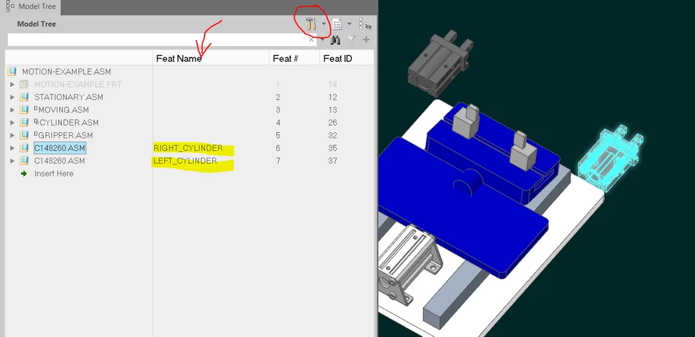

In Creo, the components in your assembly are features of the assembly.
You can name features.  However, the name column might not be present and needs to be added to the model tree.
Use the "Hammer and screwdriver" icon, then "Tree Columns" then in the "info" type of database items, pick "Feature Name" to be displayed.
Then you'll be able to name the components by clicking on the "empty" model tree fields (subject to Creo rules - no spaces and all caps only, and I think 31 character limit):

Thank you very much, this works just great!!
