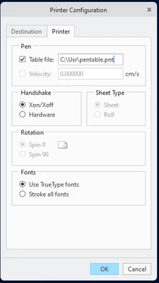

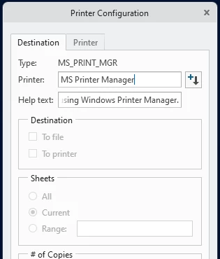

I am using this since sadly our both small format and big format printers prints differently. I am also using it for exporting pdf. Trick is to use print pdf instead of native pdf export. I have mapkey for printing on A0-A2 printer and one also which just turns off pentable for A3-A4. So you will just have 2 or more pentables and record hotkey which is going through all the printing clicks and changes the pentable path.
mapkey xda ~ Update `dwg_print_config` `i_pen_file` \
mapkey(continued) `C:\Usr\pentable.pnt`;
Also use custom size, this way you dont need 10+ variants of mapkey because of drawing size. Never had problem with it.

Thanks for the idea.
For manual plotting this would be good, but automatically changing depending on drawing format on a Worker, it's not viable unfortunately.
