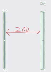

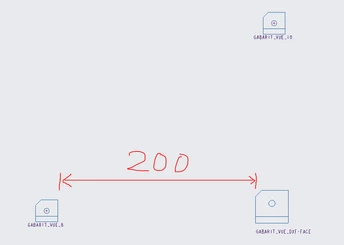

I explain my problem to you:
I need to make a 1: 1 scale plan template, the problem is that when my parts are too big, when I use my plan template, all my plans overlap (I don't know where is the left or right view) and I have to replace them by hand
So I wanted to know if it was possible to be able to give a distance between the GABARIT_VUE?
I give you captures of what I imagine
(in the creation of the template plan)
(what it would look like with a piece)
Thank you so much

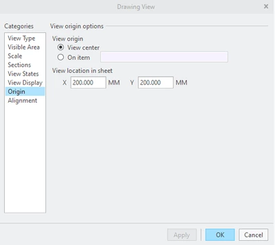

I don't know of a way to offset a view by a specific distance.  However, you can specify the location of a view in the View Properties.  Changing the Origin location will move the center of a view a specified location.  Using his you can use the location of the first view to place the other views a specific distance away.  Since the view size also incorporates all datums and hidden features the actual distance between view images will vary greatly.

Thanks for your quick reply, however i don't think this solution is workable.
First of all, I don't think I can specify this parameter when I edit my "view template" and then I would have to manually enter the value in the parameters (which will take me longer than replacing them manually. .)

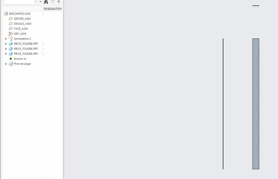

If you need to control the relative position of the components when displayed on the drawing the easiest way I can think of is to create an assembly and use the assembly model to create the views on the drawing. At any scale the positions would be maintained.

I think this solution might solve my problem
I just have to make an assembly file that automatically places my part in the desired position for my plan (if I understood correctly)
I don't know if it's possible but I think so
This is what it looks like in the assembly
I'll try it comes back to tell you if it works
