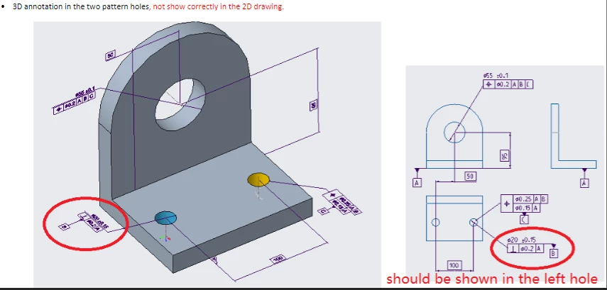

Hi ,
The dimension from pattern feature is not shown in correct place between 3D annotation and drawing.
The dimension is created in the first instance of pattern and shown correctly in 3D annotation. But it is shown in another instance of pattern in 2D drawing, not the same place as created.
Please check the picture and model & drawing for detailed information.

the result deppends on the method you used to display annotation.
See uploaded video.

Thanks a lot Martin for your feedback.
Great to see you can show that annotation correctly by showing in drawing view.
Regarding the zipped file, I firstly uploaded them all with dragging and dropping, but only the part file failed as it was not recognized by system.  so I zipped it alone not sure if the zip file was supported. I will put them all in zip file next time.
