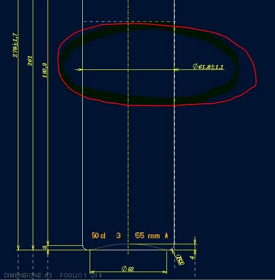

Is there a way to eliminate a quota line?
Let me explain better (or at least I try), when I go to quote a model in the .drw, I would like that the horizontal line of the linear dimension inside the model is not seen.
Attached an example.
Is it feasible in your opinion?
Ty,
Matteo.

In Creo 5.0 I can
  • select dimension
  • set Text Orientation = Horizontal
  • click Flip button
NOTE: dimension value is not placed above the dimensioning line because of Horizontal orientation

If I create a diameter dimension like this, the default is to have the line between the arrows. To get rid of the line, I select the dimension, keep holding down the left mouse button so the cursor changes to the four way arrows, then click and release the right mouse button (while still holding down the left mouse button) to change the arrow method.
